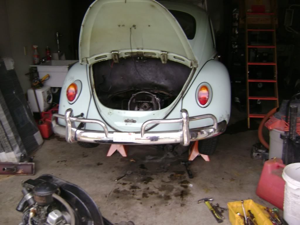

Well, I went out earlier this week to pull the motor. Figured I'd pull the heads and take them to Richard Sedoris (Aaron's guy) in Y-town. Figured I could have it out in less than an hour. Yea right. Let me tell you, compared to an early bus with a removable apron, motor pulls on beetles are a little bit of a pain. From here on out I'm cleaning a motor before the pull. Well, at least a little cleaning. The rear seal on mine is gone so the oil leak is no fun. Wait, I'm a LEAKOILER. :roll:
Anyway, I just got it out so I'll spend the weekend tearing it down then take the heads to Rich on Monday.

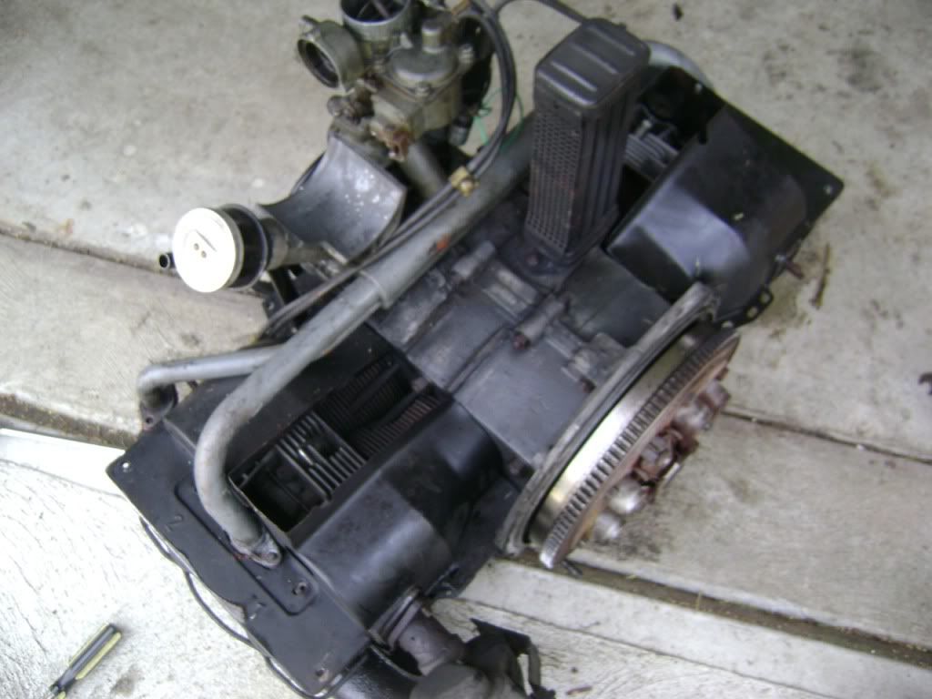

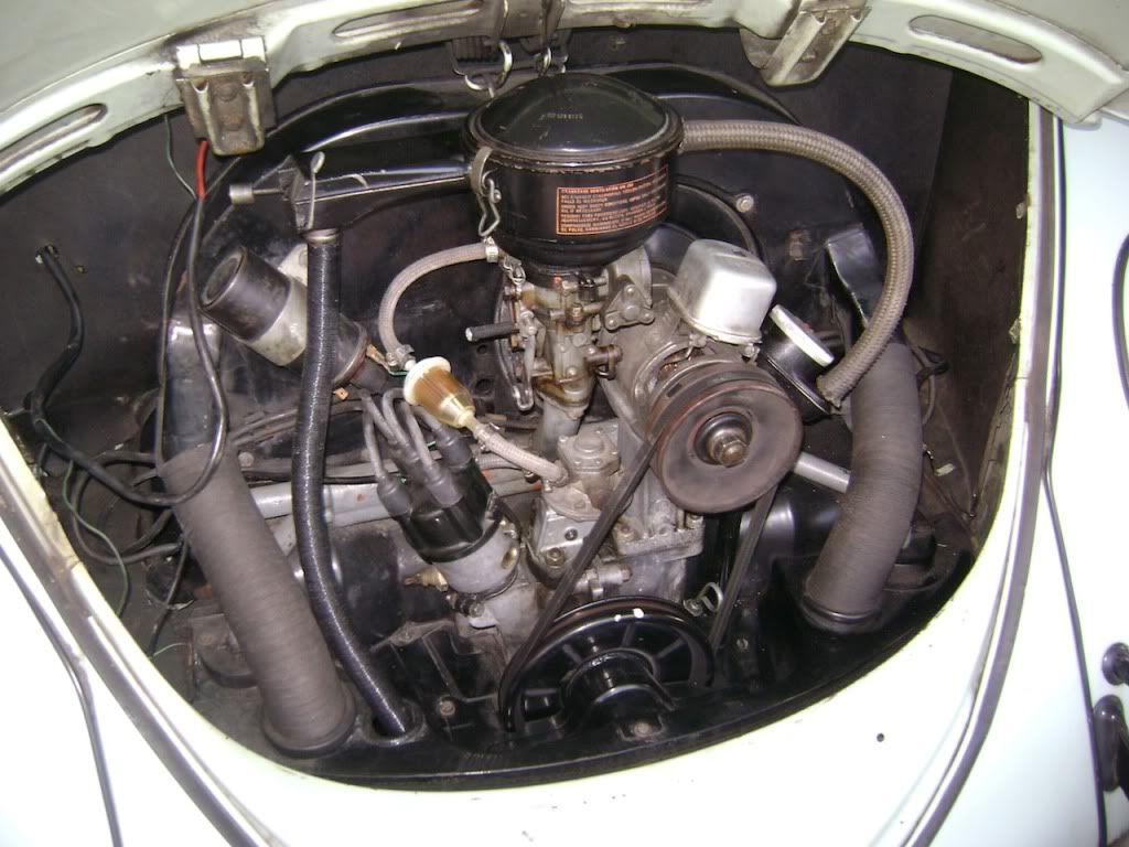

Getting ready for the pull...

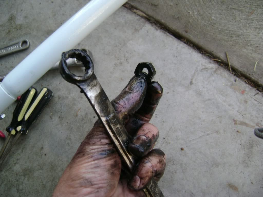

We are LEAKOILERS. Rear oil seal leaks and dirty engines are no fun when pulling 17mm nuts/bolts...

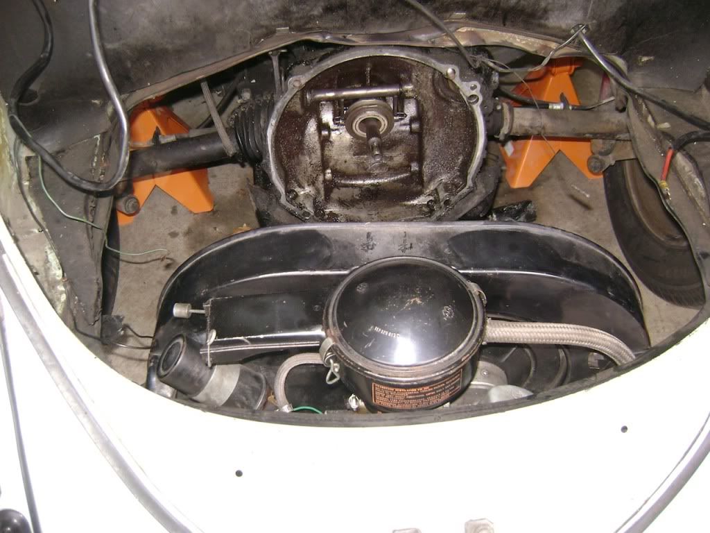

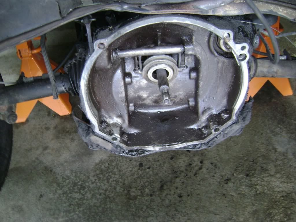

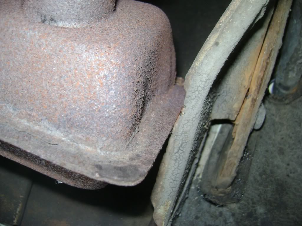

Engine was a p-a-i-n to get out. Seemed like it was hung up. Muffler was in the way.
Finally after removing the exhaust, out she came...

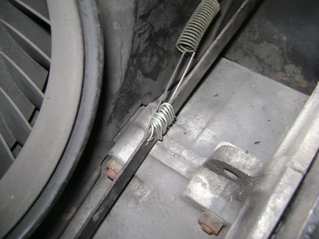

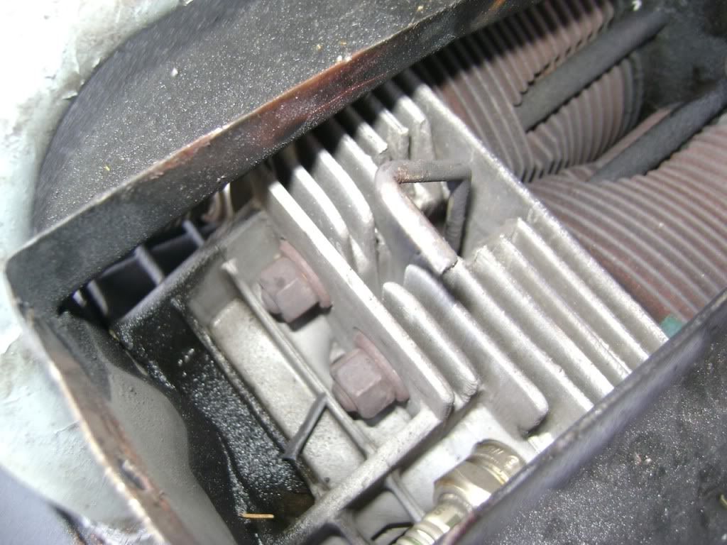

Well, "looky" here... Even though this engine appears to have a functional thermostat, the previous builder wasn't taken any chances with the flaps. Wired wide upon.

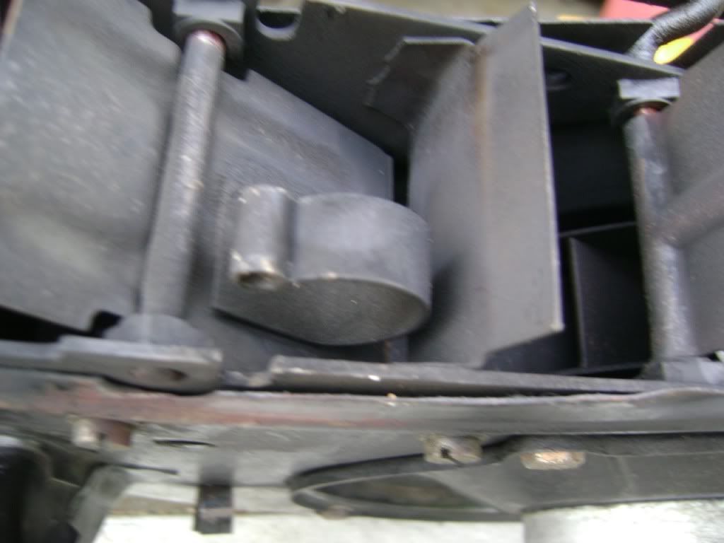

Since we're talking thermostats, other rookies like me may as well learn and see how a thermostat attaches. Here's the rod that runs up through the cylinder head from the thermostat. You can see it with the tin removed.
Now here's where that rod goes. It slips in to this little clip unit on the fan shroud.
The thermostat then controls these...

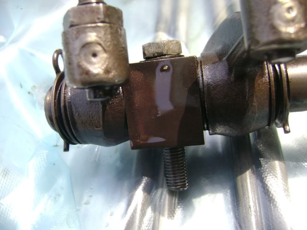

Mismatched heads? One had the bolts for the rocker arms...
The other had studs...

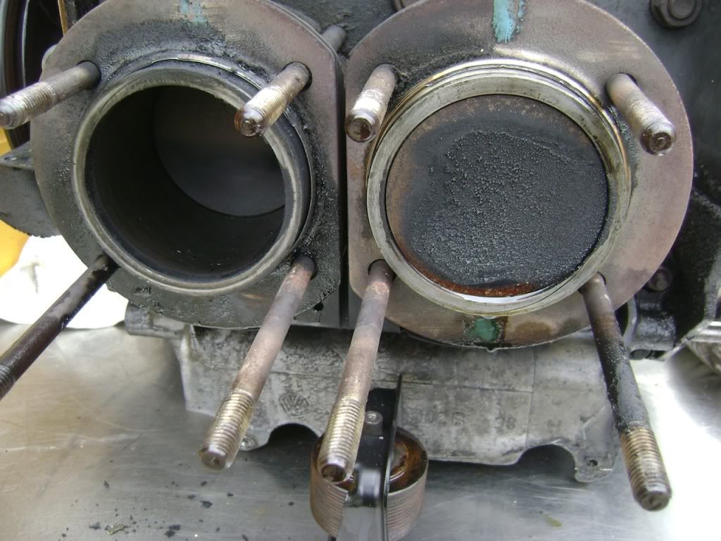

#1 & #2 cylinder/pistions

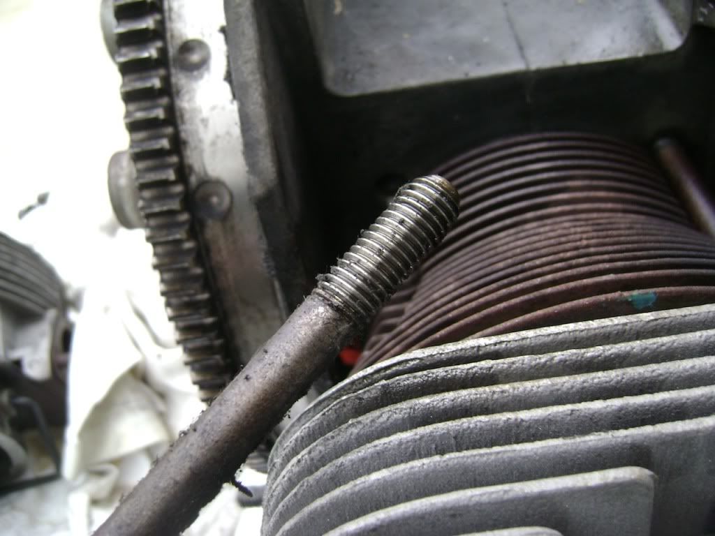

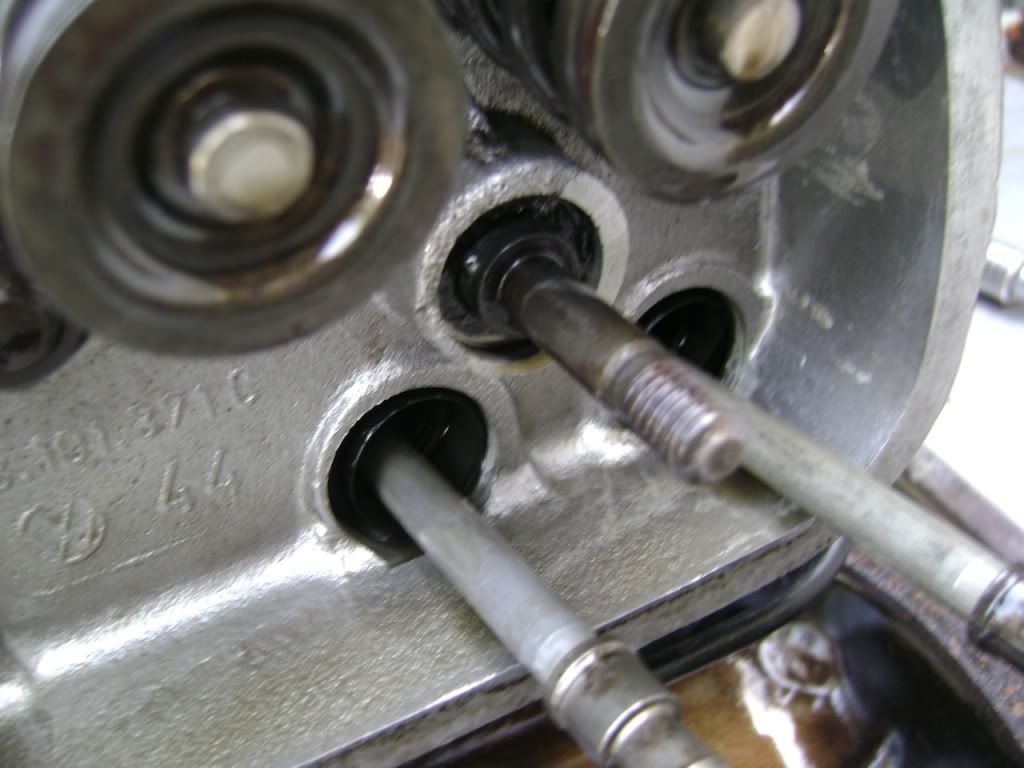

3 out of 4 top studs pulled out of the case on the #3 #4 head. Guess It'll be helicoiled at Dale's VW

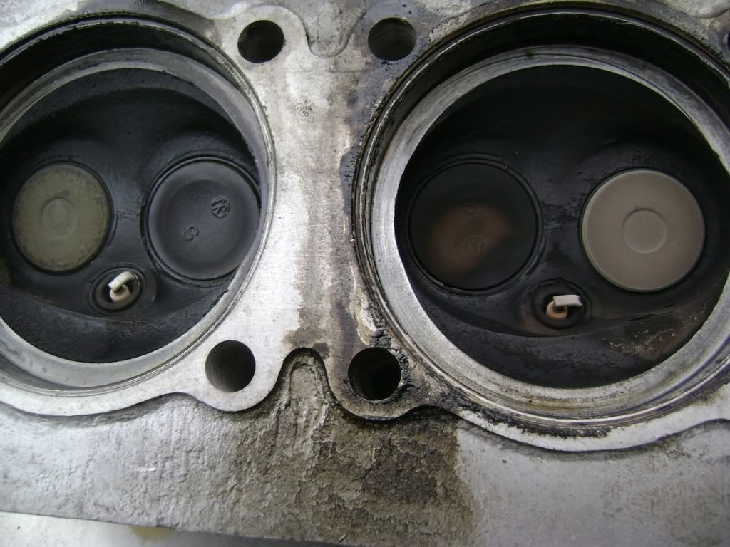

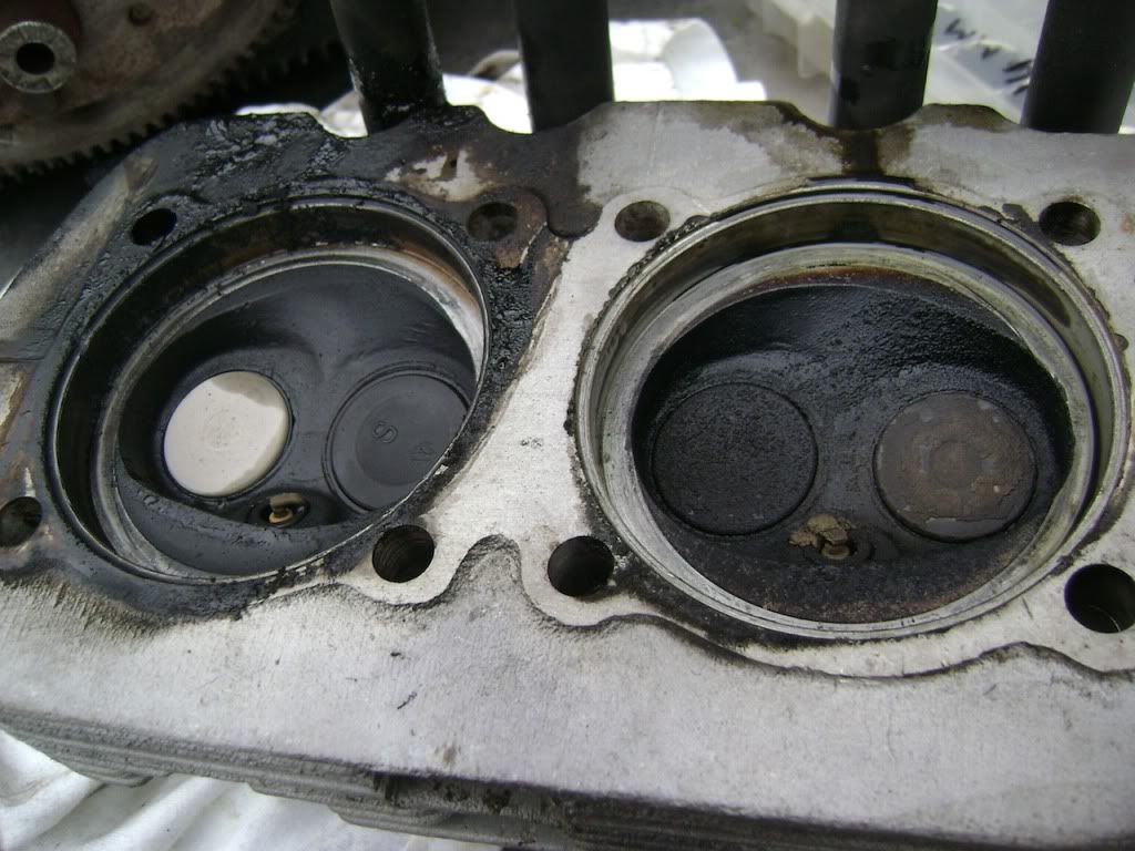

Here's the #3 #4 head. What do you see???

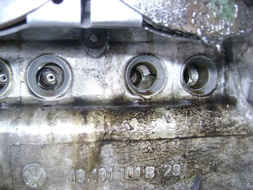

I'm a little concerned about the cam followers. I call them lifters. I guess they're the same thing. Can I get them out with a magnet? I'm wondering if one of my cam lobes is worn or the lifter is worn and that's what causing my pushrod problems. Worth a try to get them out?
While I'm at it I'm going to have to clean this, any suggestions?

The early 40 hp heads used round bosses for the rocker studs which were prone to breaking and the later ones used square bosses.
