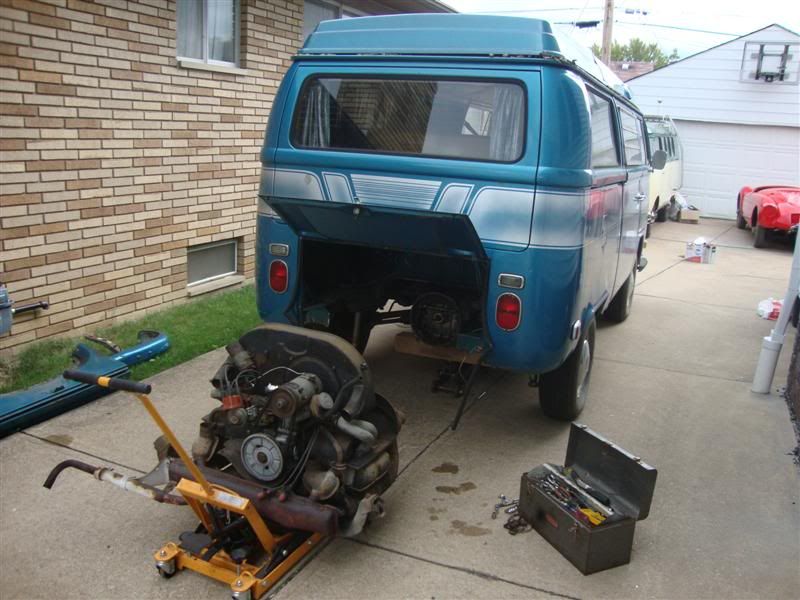

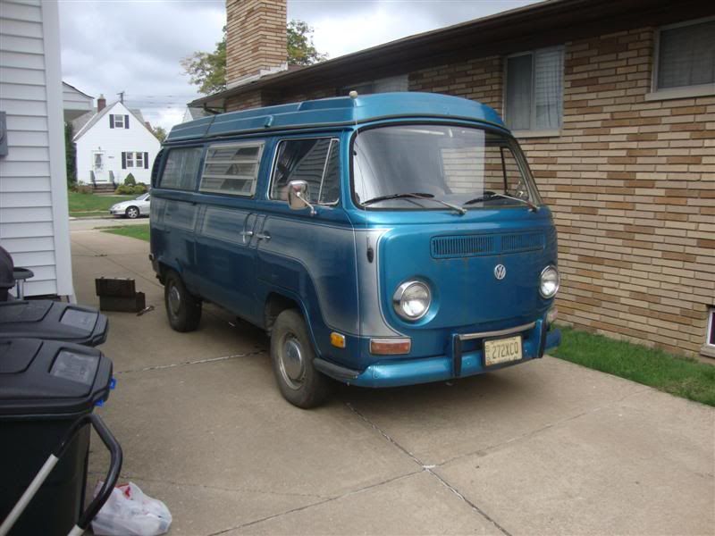

Brandon finally bit the bullet and got a bus! He had it towed to my house for a once over. The intake manifold boots were torn causing a terrible intake leak/no idle condition, and overall it just needed a good once over. Brandon replaced the intake boots, plugs, wires, cap, rotor, points, intake manifold gaskets, ignition coil, condenser, valve cover gaskets, and he went over the valve clearances. The carb is getting a good soaking, and will go on tomorrow. He also ordered some new Hankook RA08's from bus depot.
No bus enters my driveway without prompt engine removal :lol:
What a happy new bus owner!
Here's Brandon wrenching away..Image
