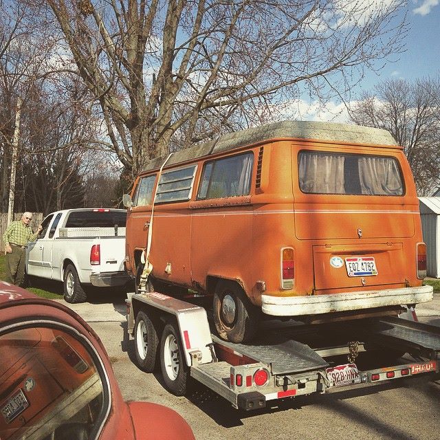

Well, I'm the one who bought Cate's orange Westy. Got it home Saturday. Not sure if it's worth saving or not, but I'm going to try. First priority will be to replace the bottom slider track! Door fell off as soon as I touched it! Looking for any help on this I can find. I'm willing to try the rest of the body work, but I don't want to mess this part up. Looking for a good welder to take care of this part, I'll do the rest!
