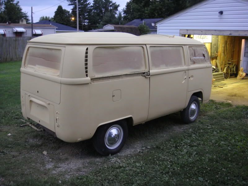

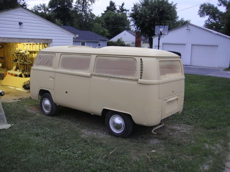

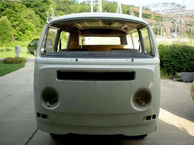

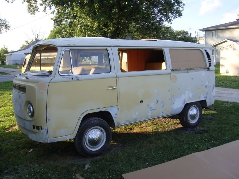

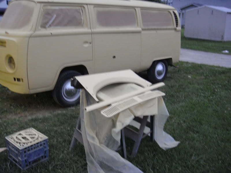

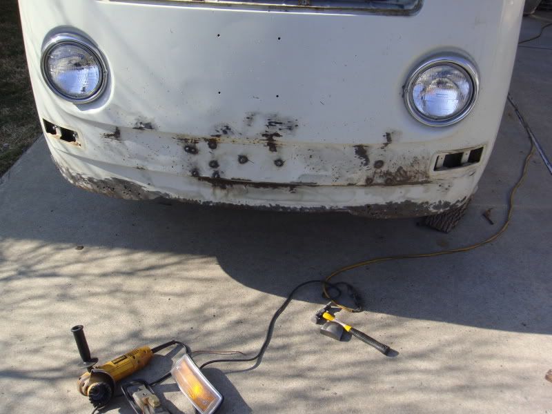

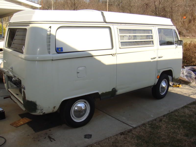

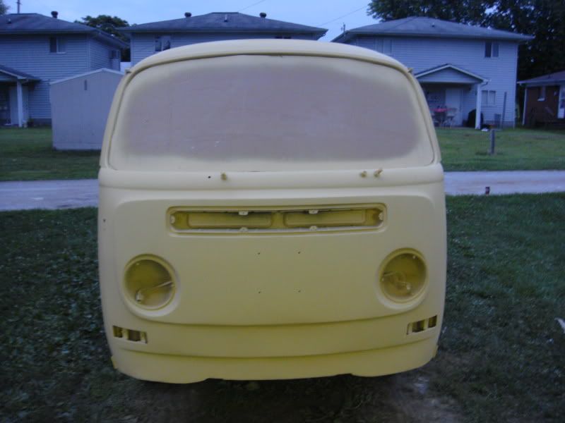

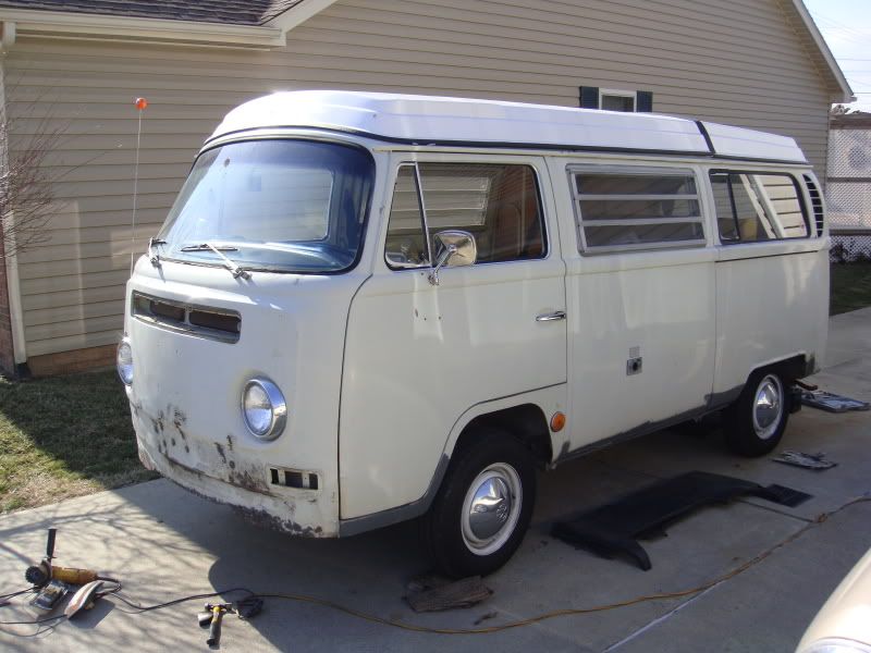

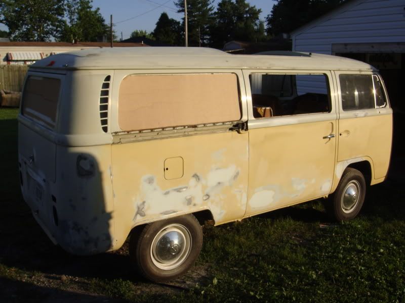

You may recognize this camper, as my dad bought it off Craig last year...Its sort of been a slow project as he has tons of other stuff hes working on..and Ive basically been doing all the work by myself...
Over all it was a nice camper to start with...Mostly og paint, and Craig had put a new motor/brakes and camper upholstery in it, and also had done alot of other work..but dad wanted it 100 percent so we tore it apart.
The body was in pretty good shape but I welded in new lower rockers and rear quarters, repaired the lower dogs legs and other misc welding.Pulled the lower nose back out as it was dented in pretty good as well as fixed some big scrapes on the pass. rear quarter. There were also about 1 million dings/dents to take care of on the sides as well...
Heres some pics...I may have some pics of it painted in the next day or so...

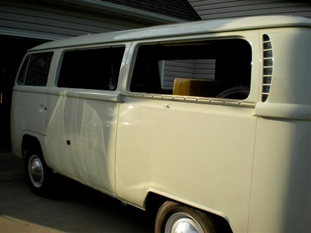

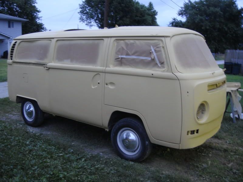

WideFive wrote:You going to spray it, or have it done? Keeping it white?
Dad found some guy in the ghetto to spray it...supposedly hes pretty good...I should know later tonight cause I think we get to pick it up...And its staying white

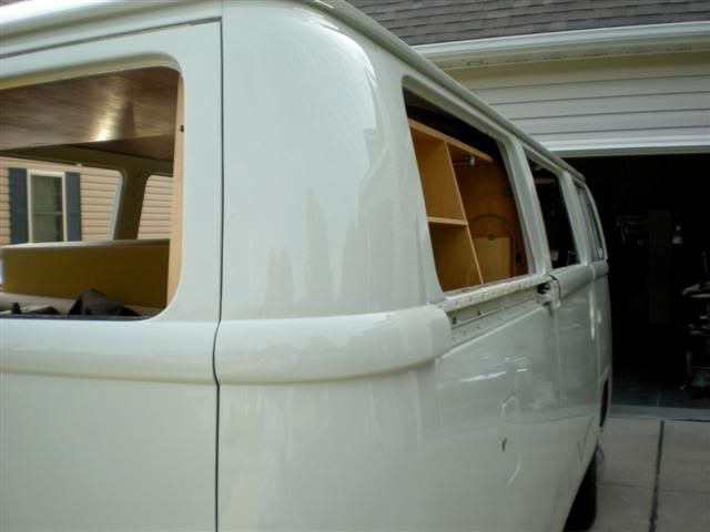

69...L87 pearl...pics in a minute to 2 hopefully
Re: Dads Camper

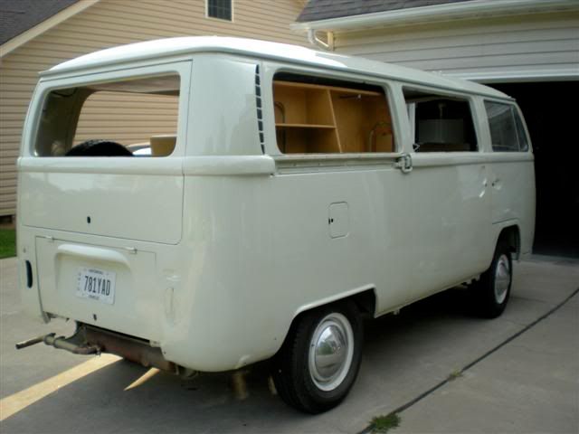

Crazy evening...
Went and got the camper with dad...it looks great the guy did a great job.
