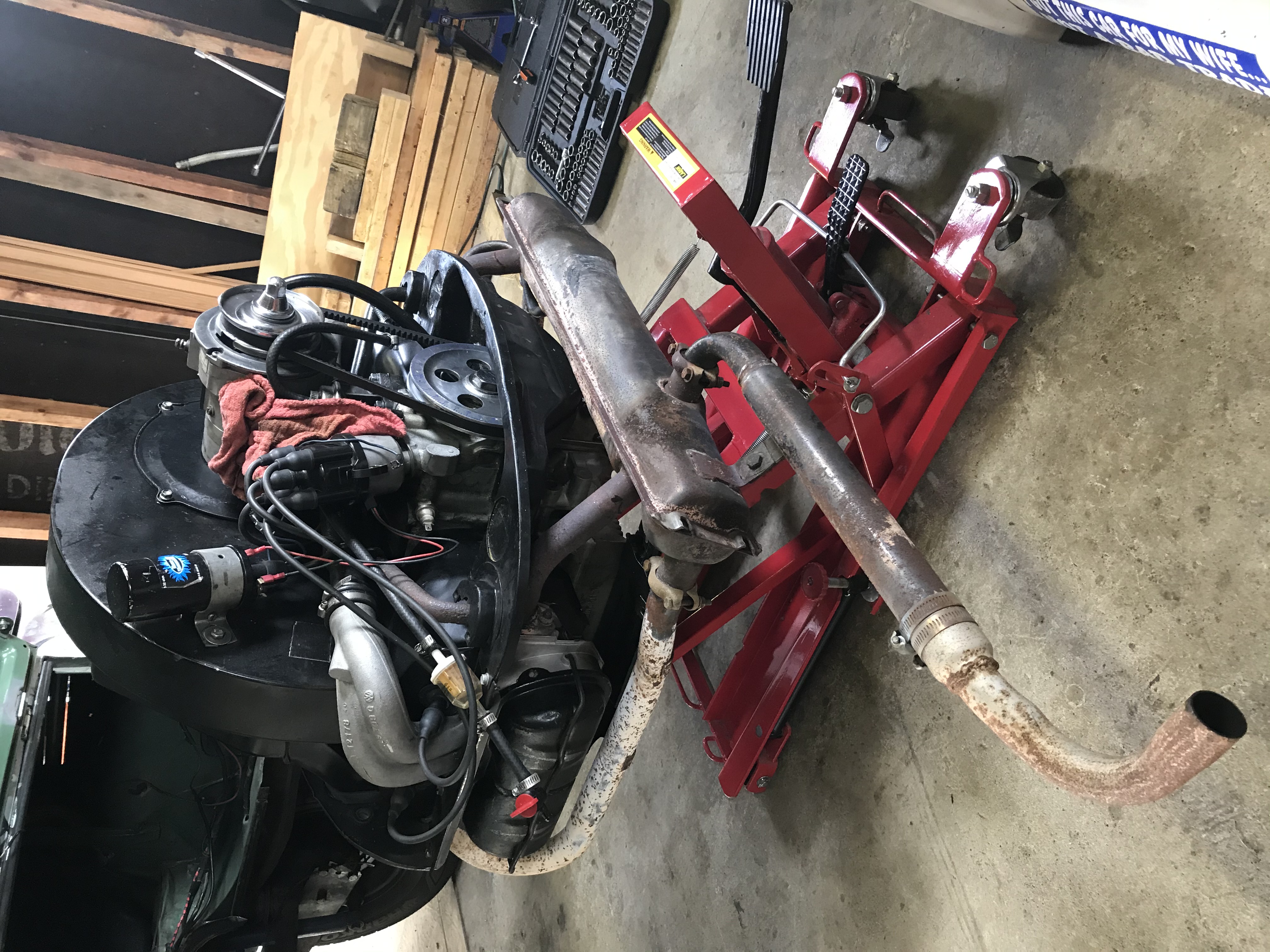

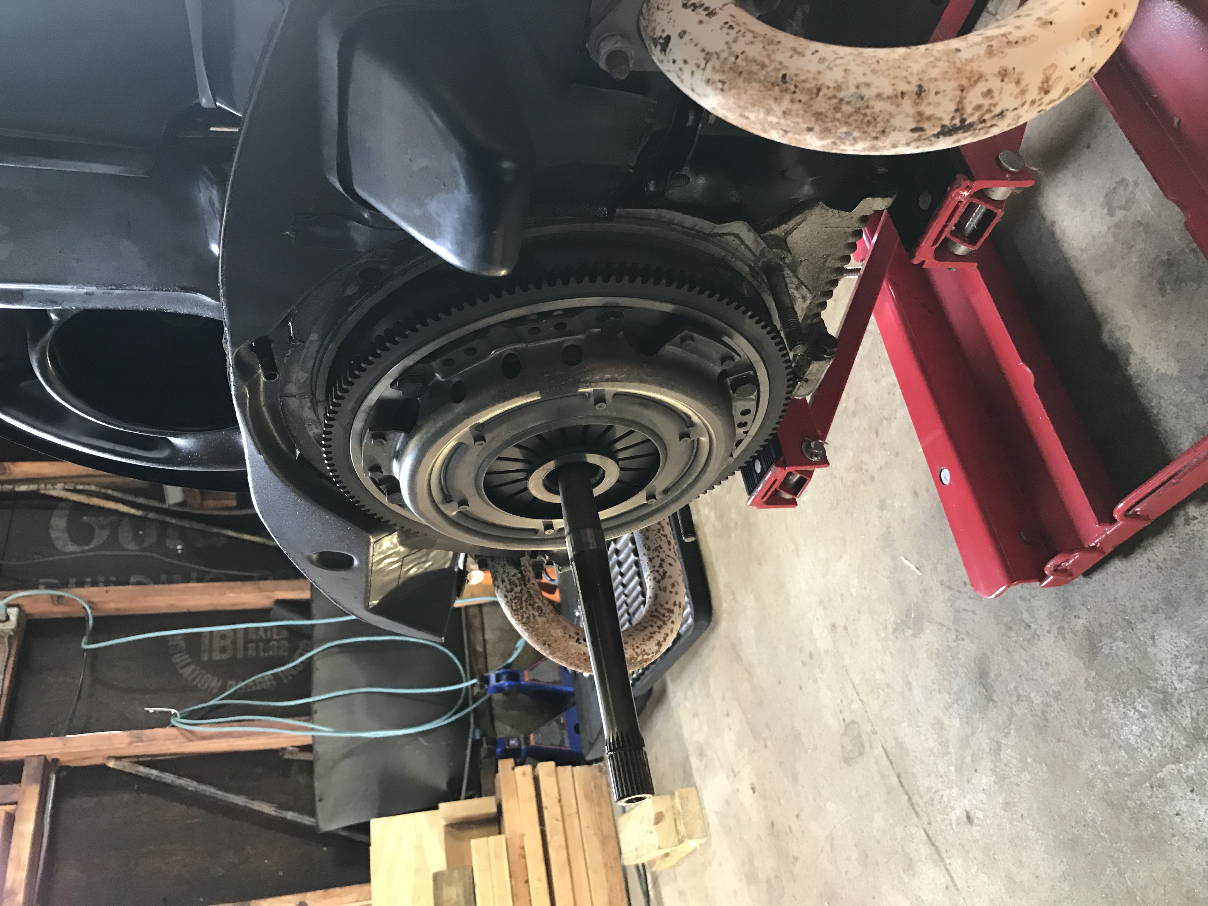

I bought a used harbor freight motorcycle jack from a friend and used it to pull my engine today. worked great engine balanced well. only problem is the rear transmission shaft came out with it, stuck fairly tight in the clutch. guess I will be taking the tranny out next.

there is a 7mm threaded stud between this shaft and the one in the tranny that is missing, It isn't on either shafts, its probably on the bottom of the tranny

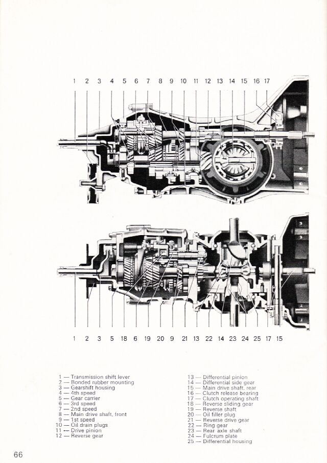

There is a snap ring that breaks allowing the reverse gear to slide and the stud breaks or un threads and the shat seperates. Need to at least tear 1 reduction box apart and pull a side cover to fix.

that snapring came out with the shaft, I believe that started the problem. the stud looks to be on the other shaft still.i am going to remove the t/o bearind and seal and try to get it back together without a teardown.

You can't because the reverse gear is now in the diff housing. The reverse gear also has the splines that mate the 2 pieces of the input shaft to transmit the power. You need to face the fact that it either get fixed right, you park it till you can fix it or you halfass it and it bites you in the ass and costs way more when the repair is rebuilding another trans when this one explodes because it was cobbled together.
Part #12 now resides in the diff housing.
