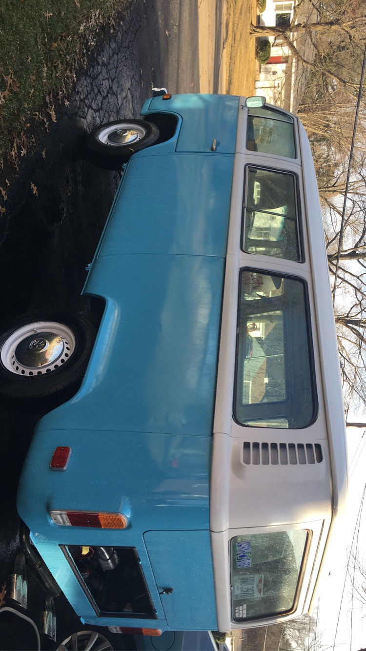

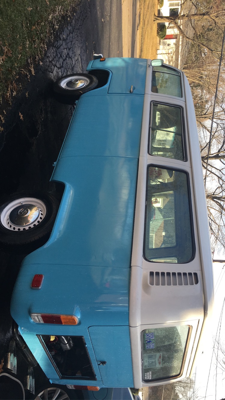

Beautiful bus Lysa. You probably need to start with a good tune up. Quite possibly ignition timing issue. Not advancing properly.

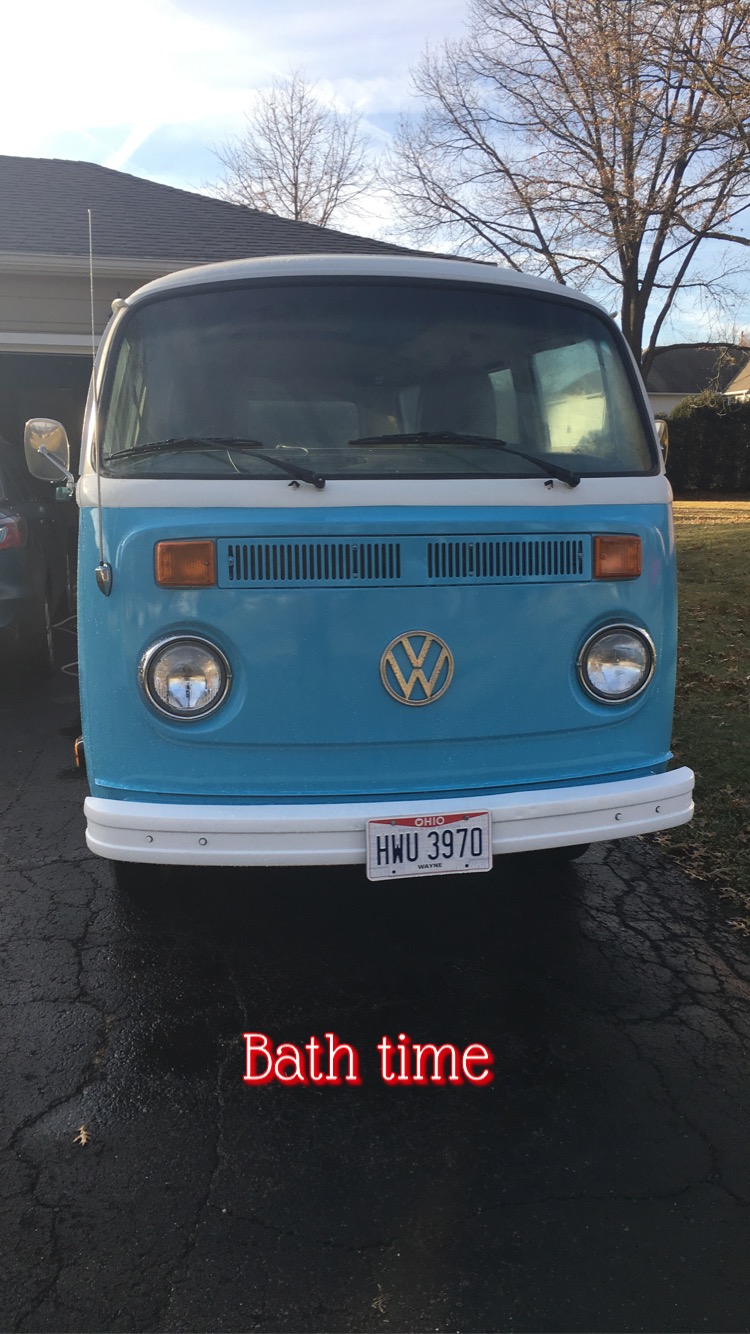

What's the story behind its history and paint? How long have you owned it?

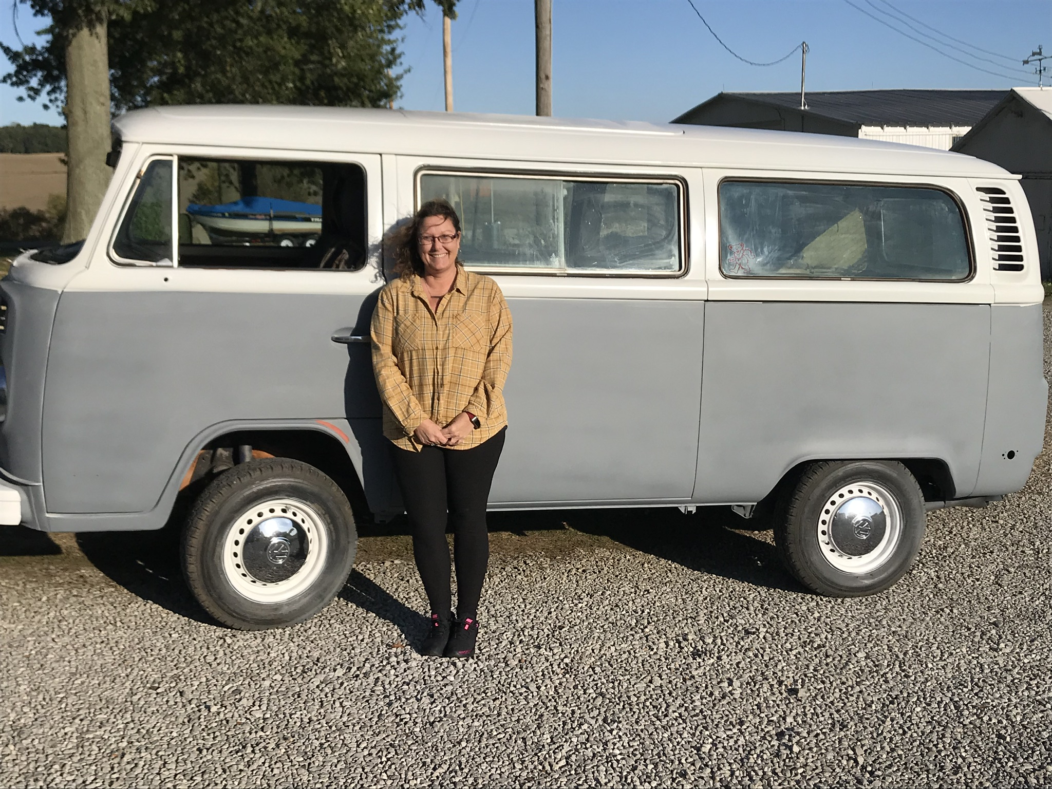

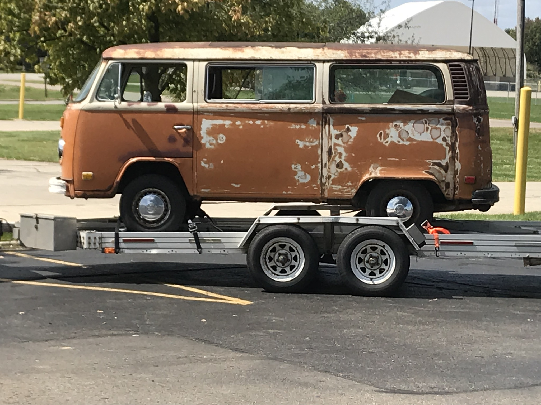

I got her last fall and my dad rebuild the engine and did the body work.. the inside is still really rough.
